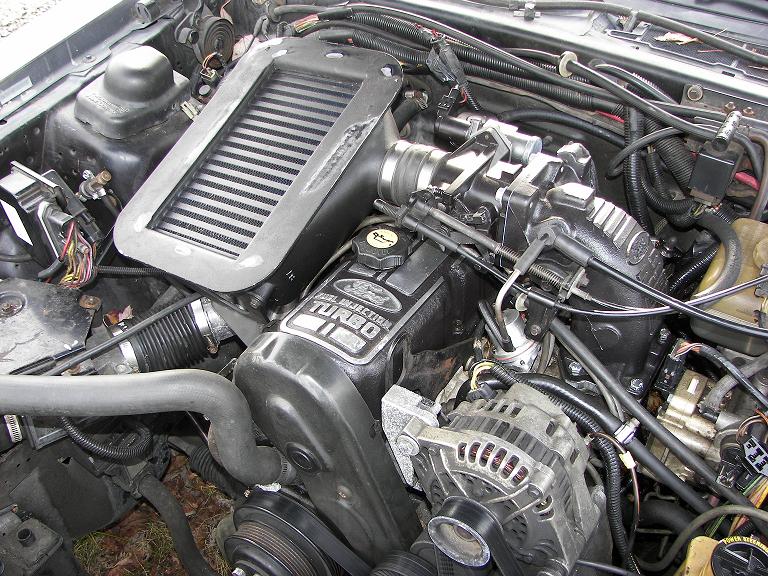

http://4.bp.blogspot.com/_iSUU432vhTA/TH...Engine.jpg
I used a homemade spacer between the upper and lower intakes to fit an older style cover on my 87tc.
Now I use a rotated plenum, but the spacer and some longer bolts from the hardware store worked great.
