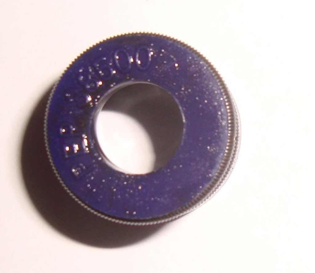

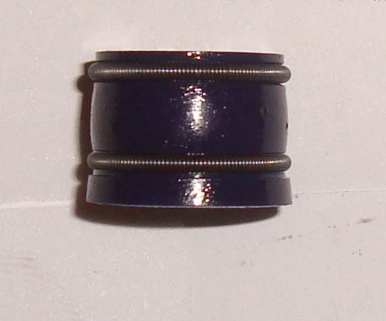

Here were the seals I took off.They came off with ease and were like jello....
http://i158.photobucket.com/albums/t97/b...ealtop.jpg
http://i158.photobucket.com/albums/t97/b...alside.jpg
I think it says part# PEP 38500
I was told they were good for turbo cars but in less than a year the car was puffing smoke.
I'm going to stick with the blue Nylon ones they sell at Esslinger.
